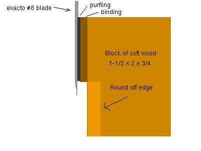

I make a gramil for every binding and perfling combination I use. It takes about 20 minutes. I glue a piece of binding and perfling to the edge of a block of soft wood. I then glue an Xacto blade to the stack. (#17 Light weight chisling. It is the kind that is beveled on one edge). See illustration:
Mike Mahar38629.6609606482
